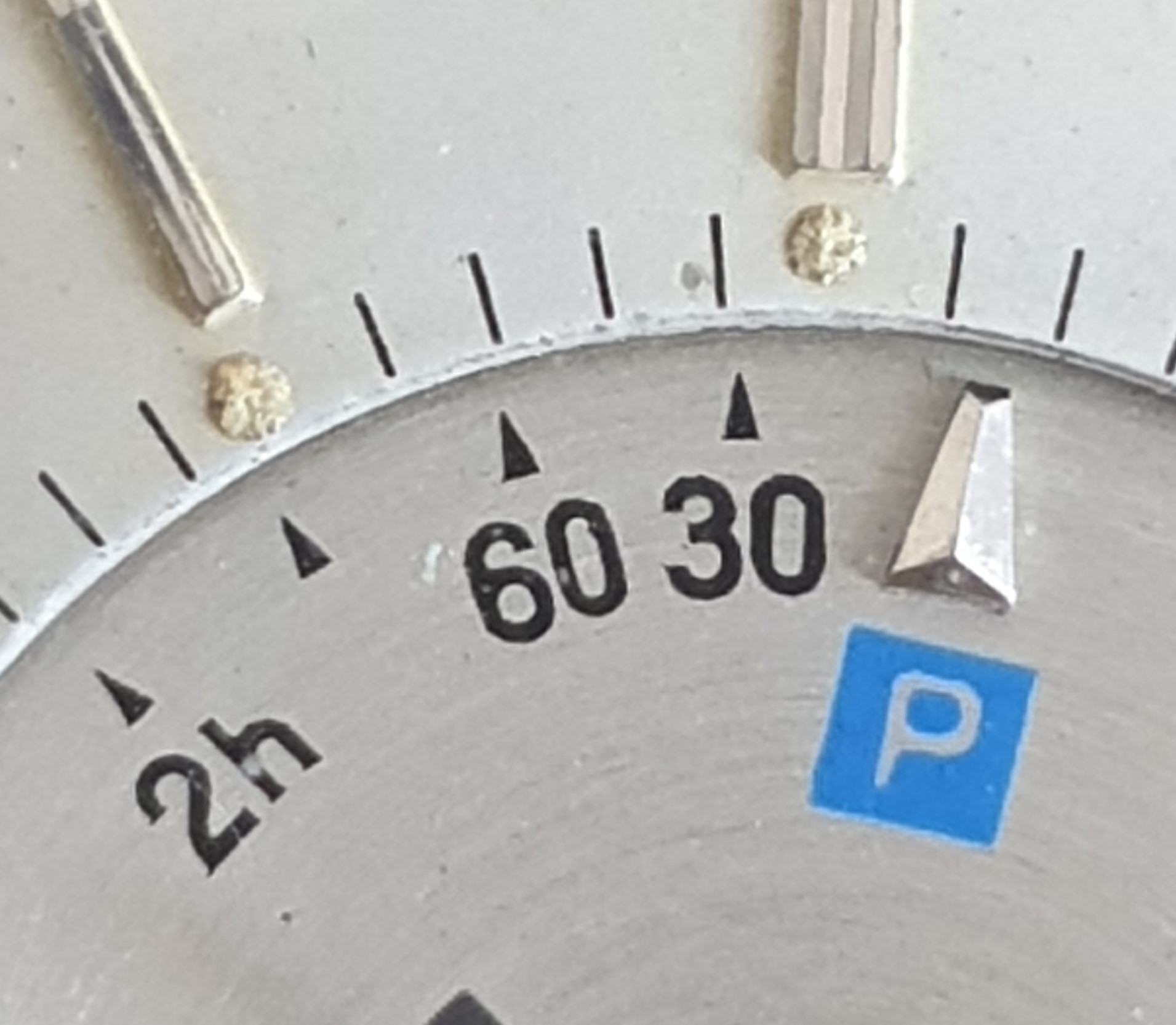

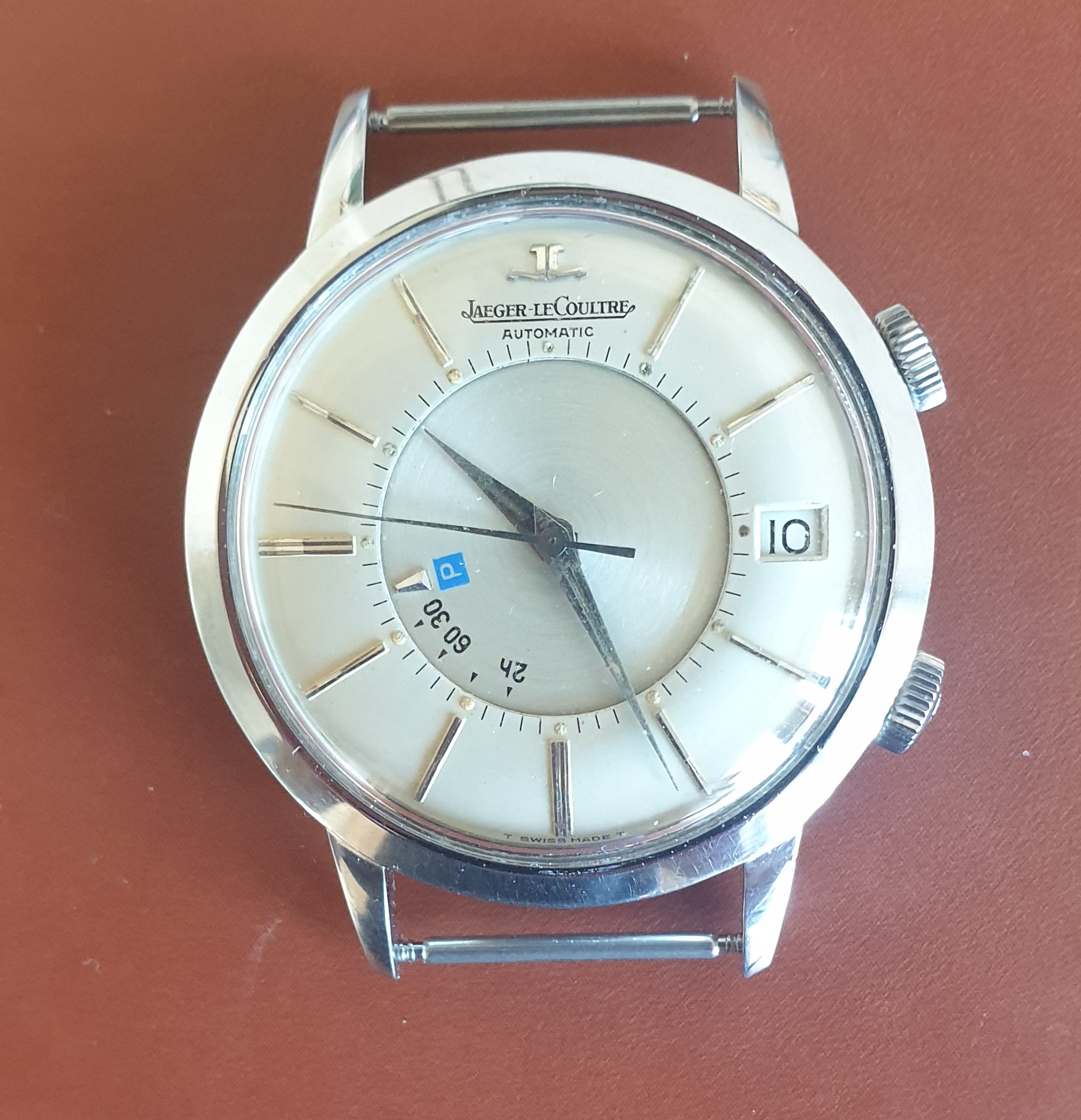

Hi! I've come across a Memovox automatic with parking function, claimed to be original.
I have some doubts about this combination, I have only seen the parking dial on manual Memovox.
Has a parking version combined with the cal 825 ever existed?
Does it make sense to think that the parking dial is a later replacement, added in order to make the watch more valuable?Could it be a combination put together by the importer of that time?
Thank you for the help!

Postby orestes » Tue Oct 12, 2021 5:26 am
Hello Zaf and thank you very much for your authoritative opinion.
My suspicion was that the disc of another Memovox had been set on this watch, so I assumed that the parking dial was genuine.
I've been told that the parking dial is repainted, do you find elements which support that?

Re: JLC Memovox Parking
Postby zafbasha » Tue Oct 12, 2021 9:18 am
On the manual wind parking, the black arrows are much closer to the dial edge, and the print is sharper.
So yes, there is a good chance it's a refinish.
Postby gatorcpa » Fri Oct 15, 2021 5:36 pm
I think Zaf is correct. I've never heard of an automatic JLC Memovox with an original "parking" dial. But I suppose the insert would fit.
Not sure if this picture is detailed enough to show what Zaf meant by the marks being closer to the edge of the dial:
I only chose this image (my watch) because I know that the parking dial is original, due to the Gubelin logo.
