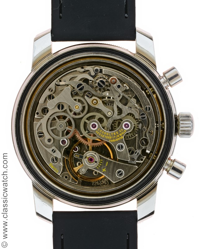

Hi there,
I'm new to this forum, but not to Jaeger LeCoultre.
I do have a question about a potential purchase though:
I am aware that the US movements had three lines of text including the number of jewels etc.. but on this movement there is a 4th line that I have not seen before on the LeCoultre Valjoux 72. 'Swiss' on the Y bridge - It seems in keeping with the 'Swiss' marked on the train wheel bridge from a font type and maybe the markings varied ?
I do have ' A guide to the collector' (which is fantastic BTW) but I can't see a reference to this that may help - Ultimately I am trying to ascertain if this watch looks genuine before I look to buy it.
Thanks for any help you may have.
Rgds, Will

I see what your are saying, but it doesn't bother me. There are variants, though yes, one would expect 3 lines.
I think the watch is fine. Do the warranty papers macth the watch?

Thanks Zaf,
That was my gut feel - I guess there were variants over time.
Guarantee paper is blank so it may well have been gathered separately over time.
Do you know if the shark diver had a criss cross crown normally or were they blank or did they vary ?

The Shark is included in the next edition of the book.
At the time of the book (2008), I did not have a nice enough example of the Shark to include, but I know have a full set example in quasi unworn condition so it will make the next edition.
The cross as cross hatch, just like the Polaris. Same era plus or minus.
